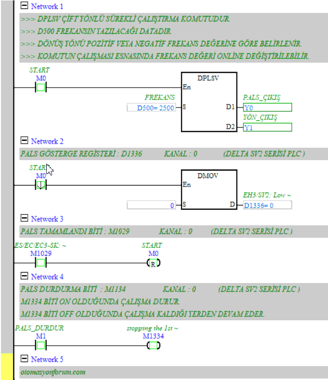

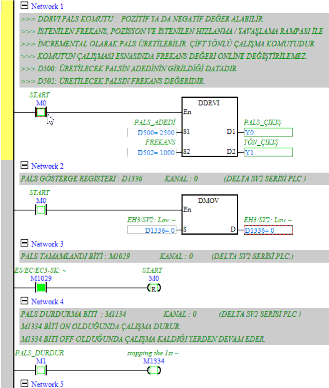

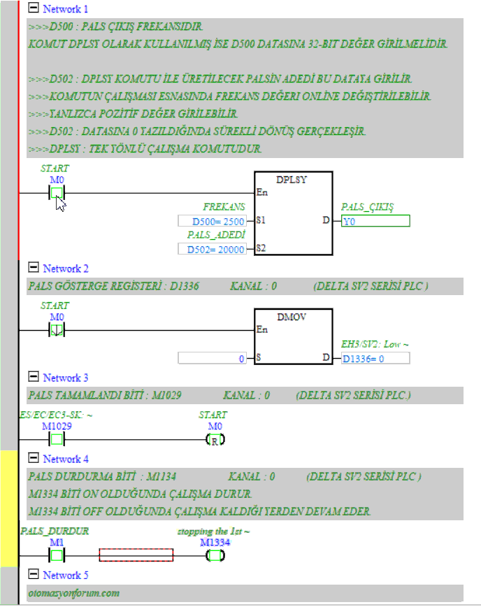

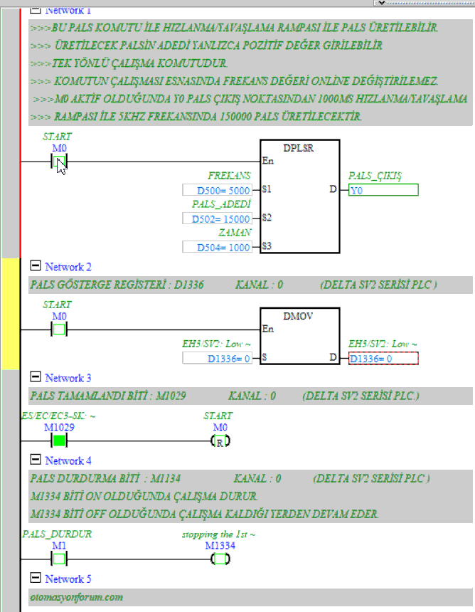

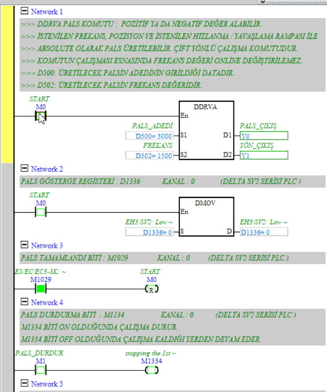

DELTA PLC - PALS KOMUT KULLANIM ÖRNEKLERİ - GİF ANİMASYON
